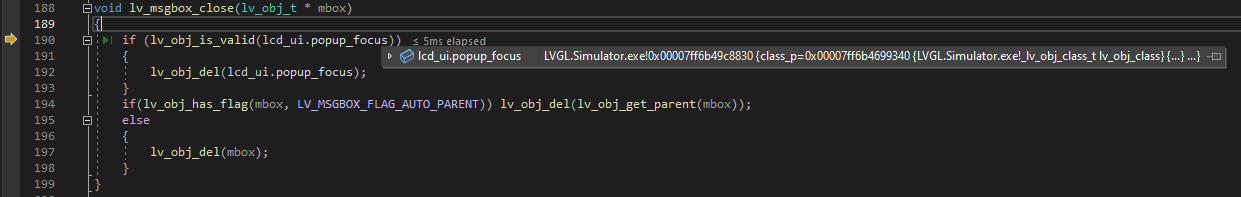

Now when a user selects a button or presses exit it’ll call the lv_msgbox_close function, which I’ve slightly modified to check if the background shader exists and delete it too. We can see all is fine when this happens:
You can also see objects pointer. Of course this passes the lv_obj_is_valid check:

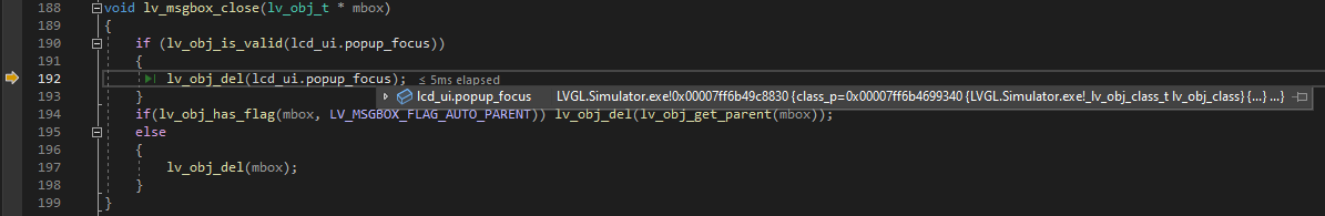

But when I step inside the lv_obj_del function:

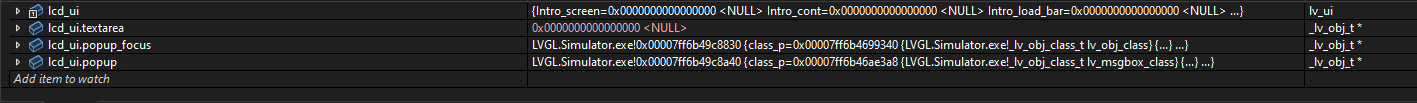

The object pointer is now changed to that is suppose to be “lcd_ui.textarea”, when we step out of the lv_obj_del function, we can see that it was in fact “lcd_ui.textarea” that was deleted:
I’m at a total loss on how this is happening. I’m going to try to revert to an older version of visual studio and see if it fixes this issue.
Reverting to older versions of Visual Studio did not resolve the issues.
