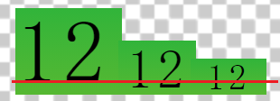

I have a problem with the bottom of text in label.
As the picture in Problem and Expectation, How do I remove the redundant space at the top and bottom or either of them?

I’m not sure if you can remove all of it, as IIRC the font enforces some amount of space above/below for letters like g and y which stretch below the baseline.
I have some text with different fonts.
The larger font => the larger the distance of above/below.
So It’s hard to align those text on a straight line.
Do you have any idea?
Problem
Expect
You can’t remove them because this is how the font looks like. As @embeddedt the top and bottom space is reserved for letters like ÁÉŐygp.
At worst case you can put the text on an lv_obj set its size as you wish and position the label to clip the extra area.
